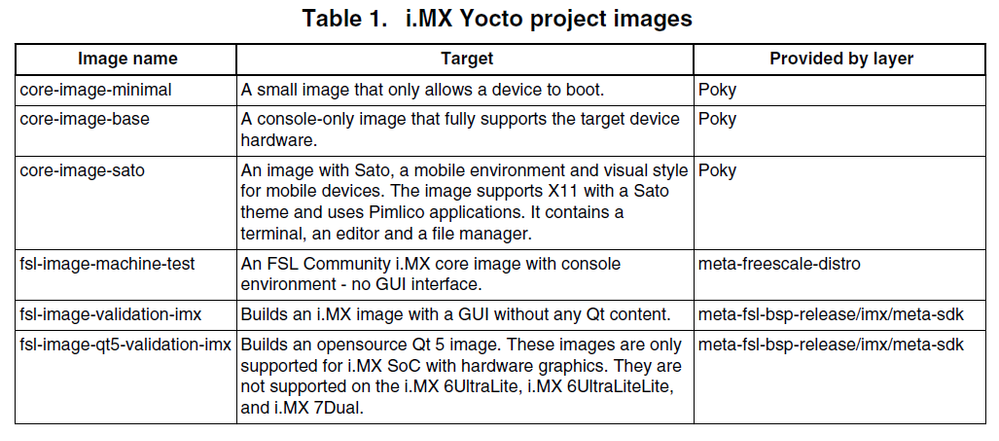

jimmychan
You can read the i.MX_Yocto_Project_User's_Guide and i.MX_Linux_User's_Guide about the information of QT in the BSP.
you can find the QT related receipts in the meta-fsl-bsp-release/imx/meta-sdk
