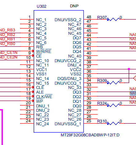

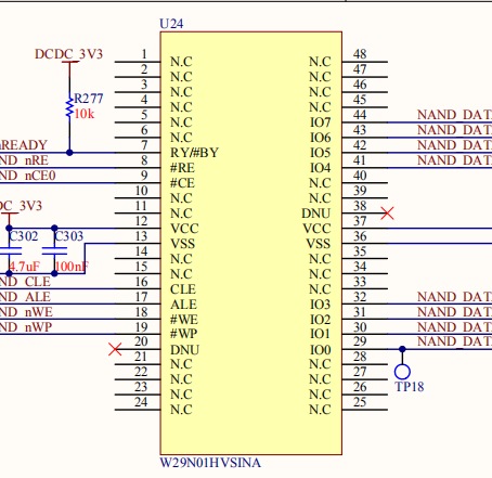

hello,
       I have removed the qspi flash from evk board and solder U302 W29n01hv NAND FLASH on the EVK board, that the flash pins is the same with MT29G08CBADBWP
and now I recompile the uboot follow the steps:
1: make distclean;
2: make mx6ull_14x14_evk_nand_defconfig
3: make

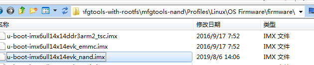

and replaced the firmware/u-boot-imx6ull14x14evk_nand with u-boot-dtb.imx, and the same with files u-boot-imx6ull14x14evk_nand.imx

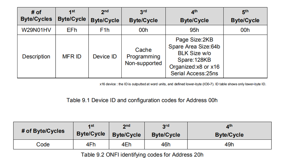

so It seems Nand has been recognized, but not configured correctly?

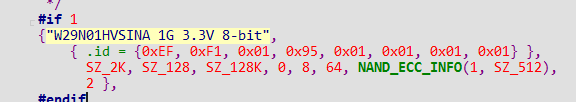

EXTENDED_ID_NAND("NAND 128MiB 3,3V 8-bit",  0xF1, 128, 0x0),
should I added those item like this:
{"W29N01HVSINA 1G 3.3V 8-bit",
{ .id = {0xEF, 0xF1, 0x00, 0x95, 0x00, 0x00, 0x00, 0x00} },
SZ_2K, SZ_128, SZ_128K, 0, 5, 64, NAND_ECC_INFO(1, SZ_512),
2 },
pagesize: 2048
chipsize: 1Gbit, 128
erasesize: 128
option: 0x0
id_len: 5
oobsize: 64
Nand_ECC_INFO: ?
onfi_timing_defualt: ?

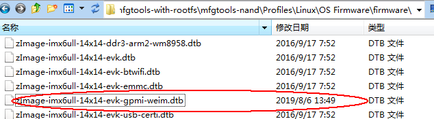

and the dts file is :

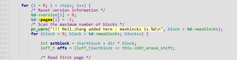

       I have added comments in search_bbt function:
      got log like this:

yes, there is one item matched.
EXTENDED_ID_NAND("NAND 128MiB 3,3V 8-bit",  0xF1, 128, LP_OPTIONS),
6,270 Views

I have added item in nand_ids.c
and got log like this:

Loading Environment from NAND... !!! Neil.zhang added here :chip->ecc_strength_ds = 1, chip->ecc_step_ds = 512, mtd->oobsize is 64
!!! Neil.zhang added here : maxblocks is 4
Bad block table not found for chip 0
nand_bbt: error while writing bad block table -5
*** Warning - bad CRC, using default environment
Failed (-5)
   Does this means I need to disable this option?
   nand->bbt_options = NAND_BBT_USE_FLASH | NAND_BBT_NO_OOB;

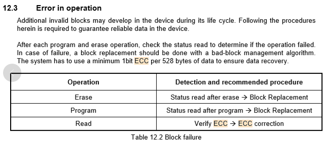

   and NAND_ECC_INFO(1, SZ512), I am not sure that this configuation is correct. can you help me check this?
   or NAND_ECC_INFO(1, 528) is correct?

guochgz
Currently, the problem points to the erase problem of Nand flash. When the 60h, d0h command is executed, the 70h command is used to read the status, and the value returned is 0xFF, not 0x40.
log is:
nand: device found, Manufacturer ID: 0xef, Chip ID: 0xf1
nand: Unknown W29N01HVSINA 1G 3.3V 8-bit
nand: 128 MiB, SLC, erase size: 128 KiB, page size: 2048, OOB size: 64
gpmi-nand 1806000.gpmi-nand: use legacy bch geometry
Scanning device for bad blocks
nand: status = 0xff
nand: nand_erase_nand: failed erase, page 0x0000ffc0
The original datasheet is attached in the top post. the block erase seq as follow:

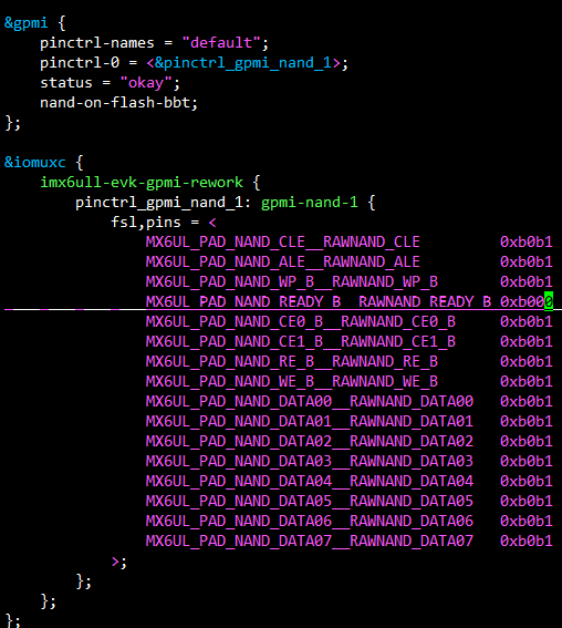

guochgz
Thanks igor,
I have checked it.

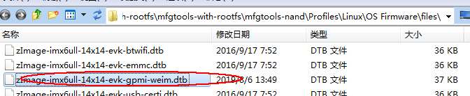

the dts file is:
#include "imx6ul-14x14-evk.dts"
&qspi{
status = "disabled";
&usdhc2 {
&gpmi {
pinctrl-names = "default";
pinctrl-0 = <&pinctrl_gpmi_nand_1>;
status = "okay";
nand-on-flash-bbt;
&iomuxc {
imx6ul-evk {
pinctrl_gpmi_nand_1: gpmi-nand-1 {
fsl,pins = <
MX6UL_PAD_NAND_CLE__RAWNAND_CLE 0xb0b1
MX6UL_PAD_NAND_ALE__RAWNAND_ALE 0xb0b1
MX6UL_PAD_NAND_WP_B__RAWNAND_WP_B 0xb0b1
MX6UL_PAD_NAND_READY_B__RAWNAND_READY_B 0xb000
MX6UL_PAD_NAND_CE0_B__RAWNAND_CE0_B 0xb0b1
MX6UL_PAD_NAND_CE1_B__RAWNAND_CE1_B 0xb0b1
MX6UL_PAD_NAND_RE_B__RAWNAND_RE_B 0xb0b1
MX6UL_PAD_NAND_WE_B__RAWNAND_WE_B 0xb0b1
MX6UL_PAD_NAND_DATA00__RAWNAND_DATA00 0xb0b1
MX6UL_PAD_NAND_DATA01__RAWNAND_DATA01 0xb0b1
MX6UL_PAD_NAND_DATA02__RAWNAND_DATA02 0xb0b1
MX6UL_PAD_NAND_DATA03__RAWNAND_DATA03 0xb0b1
MX6UL_PAD_NAND_DATA04__RAWNAND_DATA04 0xb0b1
MX6UL_PAD_NAND_DATA05__RAWNAND_DATA05 0xb0b1
MX6UL_PAD_NAND_DATA06__RAWNAND_DATA06 0xb0b1
MX6UL_PAD_NAND_DATA07__RAWNAND_DATA07 0xb0b1
