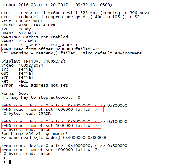

      I used uboot-imx-imx_v2016.03_4.1.15_2.0.0_ga source code on my IMX6UL board, but it failed when read data from nand flash(MT29F2G08ABAEA),below is the information:
      => nand read ${loadaddr} 0x4000000 0x800000
      NAND read: device 0 offset 0x4000000, size 0x800000
      NAND read from offset 4000000 failed -74
      0 bytes read: ERROR

jasonshao
Hi igor,
They are the same thing. When boot from nand,it need read env settings and kernel from Nand flash,all failed. When I do a 'nand read' comman in main_loop console manually, it failed too. The EEROR information are all like this:
      "NAND read from offset xx failed -74"
Below is detials:
2,623 Views

jasonshao
yes, it reach uboot prompt.But can not read data out from the Nand, the error information as described above.
