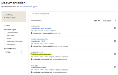

Hello @DusanStanisic99 ,
that might be a small bug in the driver. Your observation seems to be correct to me.
Please refer to TJA1120's application note, AN13663, page 30 - where startup timing is depicted.
Pavel
