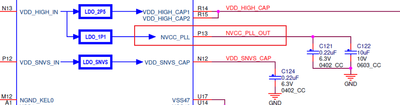

Hi!
On the iMX6 there is the NVCC_PLL pad. Would the internal PLL LDO and internal systems benefit from a cap such as the Cornell FCA?  https://www.cde.com/resources/catalogs/FCA.pdf

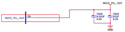

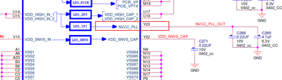

Hi limacon,
See below, please!
1. iMX6Q/D/DL/S Processor.
2 . imx6ul/ull/ulz
3. iMX6SX
Ceramic capacitors can be used.
