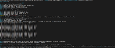

Hi @AB22
Is that able to upgrade the kernel version to 6.12.y? You can try  to download 6.12.y bsp from toradex website.
Zhiming
6,182件の閲覧回数
AB22
Hi @Zhiming_Liu
  I was never successful getting my Tensorflow 2.10 trained SSD Mobilenet V2 fpnlite model to run on the NPU of the i.MX8M Plus. It seems to have multiple operations that are not supported which I cannot prevent from being included. I have turned to trying to train with eIQ 1.17. I tested a model trained with eIQ (base model fpn_ssd_mobelinet_v2) and it did run on the NPU without issuing any errors. But, I am not getting quality training in the eIQ portal. I have imported my dataset which trained effectively in Tensorflow 2.10. In eIQ, I can only get my  evaluation mean average precision to about 0.045. Any suggestions as to what I might be doing incorrectly?
6,149件の閲覧回数
Zhiming_Liu
Hi @AB22
Can you share your trained model from Tensorflow 2.10? I want to run it on L6.6.23.
Zhiming

6,052件の閲覧回数
Zhiming_Liu
Hi @AB22
There is no issue on L6.6.23 BSP. Please make sure that this model can support 320x320 image input. After you check there is no issue in your program, please find support from Toradex, maybe this relates to their BSP.
Zhiming_Liu_0-1763946670004.pngZhiming_Liu_0-1763946670004.pngZhiming_Liu_1-1763946756292.pngZhiming_Liu_1-1763946756292.png
Zhiming
5,977件の閲覧回数
AB22
Hi @Zhiming_Liu
  I ran your two command line tests and they resulted in similar output with my build. Perhaps the code I am using to run the model within Qt is not correct.
Thank you
