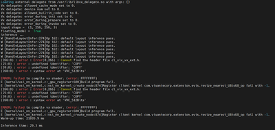

hy982530
Hello, @Bio_TICFSL
My version of BSP is 5.15.71.
I execute yolov5s-32fp-256.tflite on npu according to your teaching. My program is python and the .tflite has correct result on cpu. However, on npu, I get correct labels and predictions, but wrong bounding boxes.
in addition, some error appear when I use VX delegate. Can you tell me what's wrong?
Thank you,
7,712 Views
hy982530
I added cl_viv_vx_ext.h in version 5.15.71, and the error message in the picture disappeared.
However, I got the same result: correct labels and predictions, but wrong bounding boxes.
7,716 Views
hy982530
I roll back the version of BSP to 5.15.32 and the bounding boxes are correct!
I want to confirm whether version 5.15.71 is the cause of the incorrect results. Has anyone encountered the same problem?
