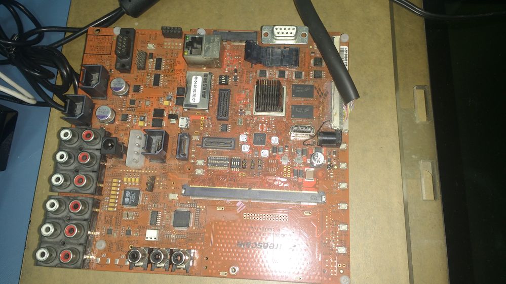

We tried with the demo images by replacing all the zImage and *.dtb files in the SD card, but still the cat /proc/mtd shows nothing in the console.
The following attachment shows the imx6q-sabreauto evolution board that we are using.IMG_20161025_185350516.jpg
6,810 Views
