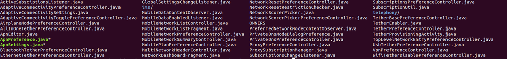

    We are using the IMX8QXP board to flash the Android car build (Android Automotive 11). Under the Settings App the Mobile Network was not displayed below look like.
    Following the below steps
     source build/envsetup.sh
     lunch mek_8q_car-userdebug
     make -j4
Below image will not displayed the Mobile network Settings
 Can you please help me out to resolve the issue?

Below observation of the Car build
AOSP using the "Settings" app source path:
Path: AA11/android_build/packages/apps/Settings/src/com/android/settings/network
AAOS build using the  Car "Settings" app
Path: AA11/android_build/packages/apps/Car/Settings/src/com/android/car/settings/network
Can you please give support us to AOSP settings app to be installed instead of the AA11 (Car Settings) app, then we can get the "Mobile Network" option enabled in the Settings App for the Automotive car build.

Thanks for your reply.
We applied those patches in android 11 aosp build, the mobile network options was displayed in the network settings. But if you are apply the same patch in the android automotive car build 11 the mobile network option was not coming.
Please help me out to display the mobile network option in android application settings for  the android automotive car build
