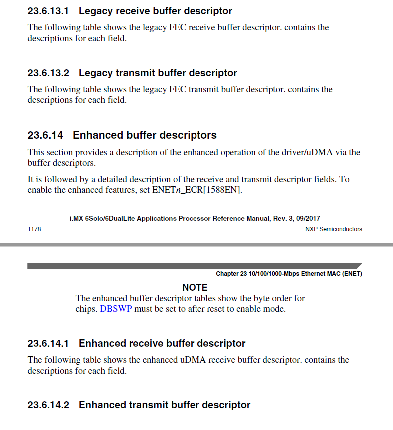

When I was referring to iMX6 Solo/DL Reference Manual (rev 3) Chapter 23 ENET, I found that there is missing table under section 23.6.13.1, 23.6.13.2, 23.6.14.1 and 23.6.14.2. It is stated the table is just following the paragraph, but I can't find any paper. Is it a typo error or there is really a missing table there?

   yes, some information disappears. Please use the enclosed old RM release.
Also i.MX6 D/Q RM may be used.

Thanks Yuri. Is there a way we can feedback to NXP about this missing information in the reference manual?

I forwarded it to the team.
