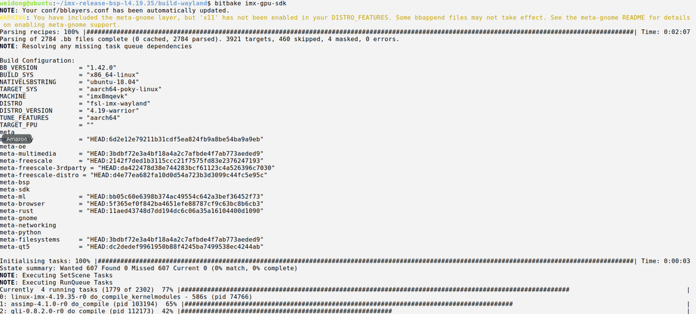

How to solve this errors below  on imx8mqevk,
Not much clarity from gtec-demo-framework/KnownIssues.md at master · NXPmicro/gtec-demo-framework · GitHub
I do # bitbake imx-gpu-sdk
ERROR: Missing installation of package 'Recipe.tclap_1_2_2' and no recipe for solving it is available
|   WARNING: no intallation validation available for recipe 'tclap-1.2.2'
| Package location: /home/mani/icefish/build/tmp/work/aarch64-mx8m-agl-linux/imx-gpu-sdk/5.3.1-r0/git/ThirdParty/Recipe/RapidVulkan_1_1_92_0
| ERROR: Missing installation of package 'Recipe.RapidVulkan_1_1_92_0' and no recipe for solving it is available
|   WARNING: no intallation validation available for recipe 'RapidVulkan-1.1.92.0'
| Package location: /home/mani/icefish/build/tmp/work/aarch64-mx8m-agl-linux/imx-gpu-sdk/5.3.1-r0/git/ThirdParty/Recipe/glm_0_9_8_5
| ERROR: Missing installation of package 'Recipe.glm_0_9_8_5' and no recipe for solving it is available
|   WARNING: no intallation validation available for recipe 'glm-0.9.8.5'
| Package location: /home/mani/icefish/build/tmp/work/aarch64-mx8m-agl-linux/imx-gpu-sdk/5.3.1-r0/git/ThirdParty/Recipe/stb_2_19_0_0
| ERROR: Missing installation of package 'Recipe.stb_2_19_0_0' and no recipe for solving it is available
|   WARNING: no intallation validation available for recipe 'stb-2.19.0.0'
| Package location: /home/mani/icefish/build/tmp/work/aarch64-mx8m-agl-linux/imx-gpu-sdk/5.3.1-r0/git/ThirdParty/Recipe/gli_0_8_2_0
| ERROR: Missing installation of package 'Recipe.gli_0_8_2_0' and no recipe for solving it is available
|   WARNING: no intallation validation available for recipe 'gli-0.8.2.0'
| Package location: /home/mani/icefish/build/tmp/work/aarch64-mx8m-agl-linux/imx-gpu-sdk/5.3.1-r0/git/ThirdParty/Recipe/RapidOpenVX_1_1_0
| ERROR: Missing installation of package 'Recipe.RapidOpenVX_1_1_0' and no recipe for solving it is available
|   WARNING: no intallation validation available for recipe 'RapidOpenVX-1.1.0'
| Package location: /home/mani/icefish/build/tmp/work/aarch64-mx8m-agl-linux/imx-gpu-sdk/5.3.1-r0/git/ThirdParty/Recipe/RapidOpenCL_1_1_0_1
| ERROR: Missing installation of package 'Recipe.RapidOpenCL_1_1_0_1' and no recipe for solving it is available
|   WARNING: no intallation validation available for recipe 'RapidOpenCL-1.1.0.1'
| Package location: /home/mani/icefish/build/tmp/work/aarch64-mx8m-agl-linux/imx-gpu-sdk/5.3.1-r0/git/ThirdParty/Recipe/RapidJSON_1_1_0
| ERROR: Missing installation of package 'Recipe.RapidJSON_1_1_0' and no recipe for solving it is available
|   WARNING: no intallation validation available for recipe 'rapidjson-1.1.0'
| Build 8 packages

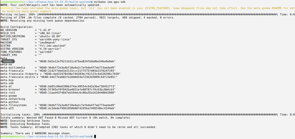

Hi Manivannan,
   I tested it just now, see steps below:
# cd ~/imx-release-bsp-l4.19.35
# DISTRO=fsl-imx-wayland MACHINE=imx8mqevk source fsl-setup-release.sh -b build-wayland
done:
no problem.
Have a nice day!

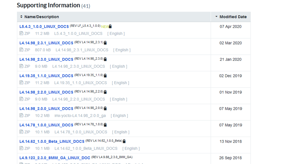

Hi Mani
    You need to download documents for linux BSP:
Embedded Linux for i.MX Applications Processors | NXP
Select one version of linux bsp you want to use, then download it.
in compressed file, you will find i.MX_User's_Guide.pdf, which will guide you how to get yocto source and linux bsp source code.
