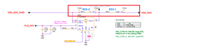

The schematic of the sense resistor I probed is as follows :

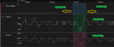

I tried to capture the SOC power for some " time window" (in which a piece of code executes ) by toggling a GPIO pin at the start and end of execution of code

Now as per the schematic diagram for the sense resistor, I can observe the following :
Rs = 1 + 0.005 = 1.005 ohm
BCU data:
I_sense = 99.5 mA
Vsense = I_sense * Rs = 99.99 mV
Please find below the waveforms observed from Saleae for the same SOC rail
With Saleae I am observing the sense voltage to be around 16 mV (whereas it is reported as 99.99 mV by BCU)
Saleae data:
V_sense+ = 880 mV
V_sense- = 864 mV
V_sense = “V_sense+” - “V_sense-” = 16 mV
So, I am not sure if there is any issue in the procedure that I followed as "Saleae" is a standard logic analyzer and ideally there shouldn't be any such mismtaches.

That is the correct way to measure it but you need to consider full-scale current and sense current equations of PAC19314 datasheet.

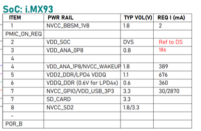

Also, in the SOM schematics, I found below table which provides details about voltages and currents drawn by each rail :
I tried to measure them by using both Logic analyzer and BCU  and these are my findings :

2) As you can see, the BCU values are not even matching with the expected currents from schematics which should be the ideal case.
So can you provide some help regarding these two queries?

The reported result in schematic is just a reference and is not guaranteed because the data presented is based on empirical measurements performed on a small sample size.
