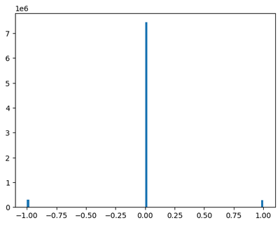

We have been working with the VX delegate to execute TFLite models on the NPU of the i.MX 8M Plus which is a VeriSilicon's VIPNano-SI+. Doing so, we have found that there are mismatches between the execution of the model in CPU and in NPU, even with a model with a single Conv2D with a 3x3 kernel and padding 'same'. This plot shows the distribution of this mismatch.

Is there a way to avoid this mismatch?
We are using TFLite Runtime 2.9.1.1 with delegate version lf-5.15.71_2.2.0.

Has there been any update on this? I believe I am experiencing the exact same issue, with the same chip. The version I am using is lf-6.1.55-2.2.2 and tensorflow 2.17.0, on a Compulab board with the same i.MX 8M Plus chip.

Unfortunately, we were unable to find a viable solution to this issue. Despite reaching out to both NXP and VeriSilicon (see this issue, where they acknowledged that "NPU integer math is not bit-accurate compared to the TFLite CPU implementation"), no resolution was provided. As a result, we have decided to discontinue working with this processor.,

Hey, thanks for your reply, much appreciated. Sorry to hear your issue wasn't resolved.. My use case is semantic segmentation, so similar to your case there is an embedding representation that gets modified too much by these bit inaccuracies. The result is that nothing gets segmented when executing on the NPU.
Fingers crossed for a way to resolve this, but I'm afraid it'll be difficult.
