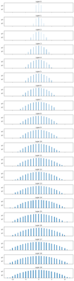

We have been working with the VX delegate to execute TFLite models on the NPU of the i.MX 8M Plus which is a VeriSilicon's VIPNano-SI+. Doing so, we have found that there are mismatches between the execution of the model in CPU and in NPU, even with a model with a single Conv2D with a 3x3 kernel and padding 'same'. This plot shows the distribution of this mismatch.
Even more, this mismatch errors propagate along different layers across the model. The attached file contains the decomposition of a model with 20 Conv2D layers into 20 models, each of them adding one layer to the previous one, allowing the measurement of the mismatch after each of the layers. The following plot shows this propagation across the model.
Is there a way to avoid this mismatch?

Unfortunately, we were unable to find a viable solution to this issue. Despite reaching out to both NXP and VeriSilicon (see this issue, where they acknowledged that "NPU integer math is not bit-accurate compared to the TFLite CPU implementation"), no resolution was provided. As a result, we have decided to discontinue working with this processor.,
