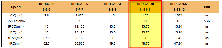

  It is needed to use DDR3-1066 or DDR3-800 (depending on i.MX6 MMDC configuration)
timing settings for SAMSUNG K4B4G1646D-BMK0, since i.MX6 supports DDR3 up to 533 MHz.
 Please look at the following regarding memory porting :
DRAM Customization on i.MX6x
  As for 0S (Linux) level, please refer to Chapter 1 (Porting U-Boot from an i.MX 6/7 Reference Board to
an i.MX 6/7 Custom Board) of “i.MX_BSP_Porting_Guide.pdf” in Linux documentation.
https://www.nxp.com/webapp/Download?colCode=L4.9.11_1.0.0_LINUX_DOCS&Parent_nodeId=13376994810717061...
The following tool will be helpful for timing tuning.
https://community.nxp.com/docs/DOC-105963
