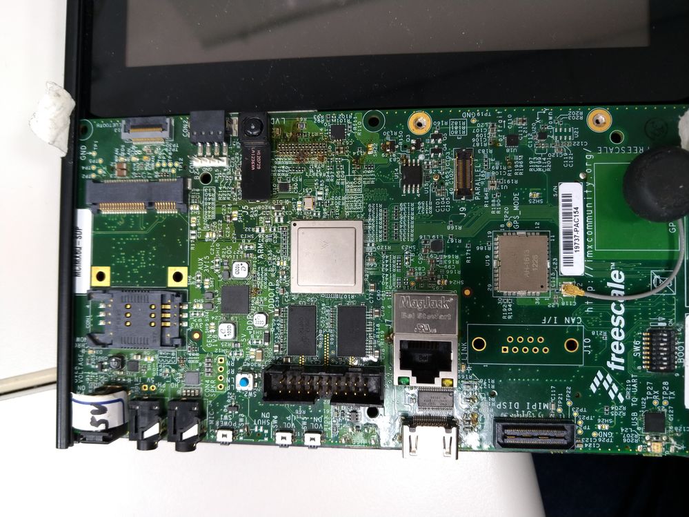

ruei_chang
Hello Rita,
   I'm using i.MX 6Quad SABRE-SD board, you can see the picture below. And I found a strange thing is when I took the MfgTool2 to another PC, it is able to find the device and burning image is okay.
    Both of my PCs are running in Win10(Chinese traditional language). Both of them are able to get the proper PID/VID.  So I think I don't' I get any wrong settings. This is very strange...
593 Views
Rita_Wang
The device "No device connected" may be caused by the PC usb version. Win7 system can work well, On Win10 system I have never try the android_O8.0.0_1.0.0_tools for burning image. I will test it with this board  i.MX 6Quad SABRE-SD board. And then give you reply.
