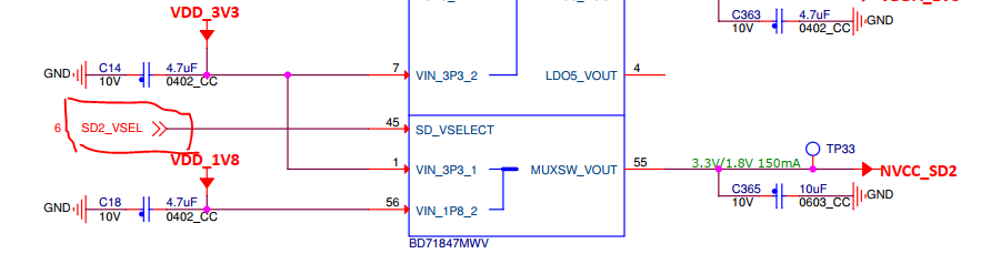

Currently I'm using the IMX8MMini EVK board, but I think the other lines have the same mechanism
1. Has anyone explained me the mechanism of action of Vselect?
How to detect 1.8V or 3.3V memory card without hardware pins?
2. Can you give me a specific example of the name Micro SD 1.8V?
I want to verify if the 1.8V card is inserted, will NVCC_SD2 become 1.8V or not?

sorry VSD_3V3 is always fixed to 3.3V, however SD2 signals can be switched
to 1.8/3.3v signalling using  NVCC_SD2 - this is done in driver automatically.
So EVK circuit supports the 3.3V and 1.8V signal modes.
Such mechanism is described in sect.10.3.4.2.3 Voltage validation
i.MX 8M Mini Applications Processor Reference Manual
and implemented in linux driver described in sect.3.3 MMC/SD/SDIO Host
i.MX Linux Reference Manual

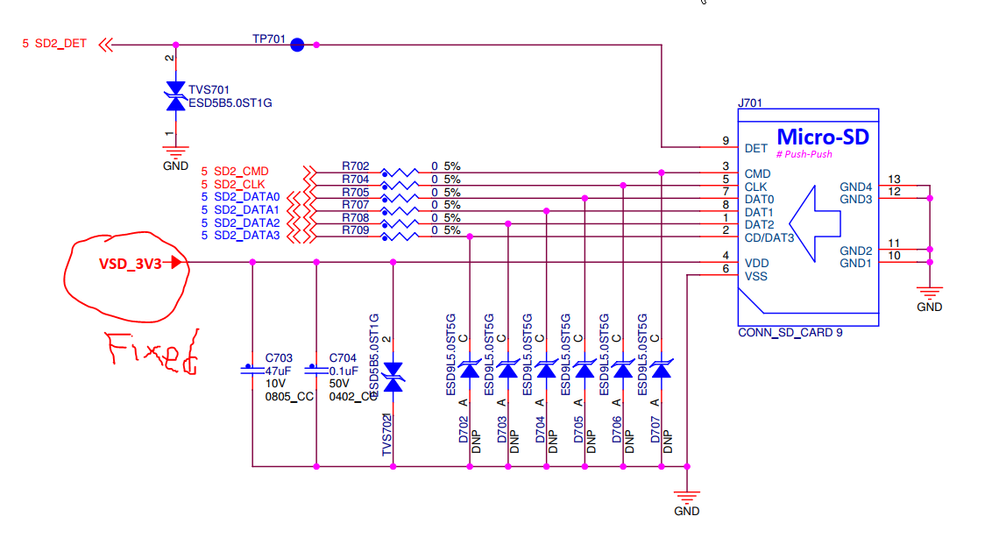

haryanl
Hi Igor
Thank for your reply
I have a rough understanding of the activity level detection mechanism
But, According to the EVK circuit, SD_SLOT VDD is fixed at 3.3V (VSD_3.3V) (Image)
Does that mean the EVK circuit only supports the 3.3V signal mode?
thanks and regards,
Yuh
3,899 Views
haryanl
Hi Igor
 >yes.
If so, must SD2_VSEL be fixed at LOW (~ NVCC_SD2 = 3.3V Always)?
can't have case SD_card VDD = 3.3V, But the signal level is equal to 1.8V? If I misunderstand, please show me

igorpadykov
Hi Yuh

haryanl
Hi Igor
thanks for your support
I had the answer
when I used UHS-I SD card, VSLECT changed from Low -> High, so NVCC_SD2 changed from 3.3V to 1.8V
While SD's VDD is still fixed at 3.3V, signals with 1.8V voltage are still guaranteed to operate normally.
I have referred to this document on pages 8 and 12
https://www.kingston.com/datasheets/SDCIT-specsheet-64gb_en.pdf
Yuh
