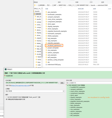

Mcuboot project not shows when importing projects with config tools
1,051 Views
shizj
As shown above. I also find the same problem with "lwip_httpscli_ota_enet", "lwip_httpscli_ota_wifi" projects.
Now I have to copy and edit the project‘s setting manually to make it detached. A really boring work. T_T
Version Info
SDK: SDK_2_11_1_EVK-MIMXRT1060
config tools: 11.0.0.202201111056
1,048 Views
shizj
Sorry a mistake. The reason is when I update the SDK and unzip files with “not over-write existing files” options. So manifest.xml is not update which config tools used to recognize SDK.
