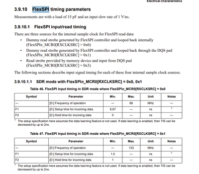

what is the maximum data rate and clock for the QSPI interface supported by i.MX8M Mini Processor?

Please refer the datasheet.
https://www.nxp.com/docs/en/data-sheet/IMX8MMCEC.pdf

Can you please confirm the maximum clock/data rate of QSPI interface supported by i.MX8M Plus processor

SDR (single data rate) SCK = 166 MHz (max). That’s 166M transfers/sec.
DDR mode also lists 166 MHz as the clock but transfers on both edges, so DDR effectively gives 2 transfers/clock (≈332 MT/s)
