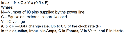

   In I.MXRT 117x , the current consumption is shown by
In I.mxRt series
N= 16 no  of pins
V =  The operating voltage of NVCC i.e 3.3
But how to calculate C and F for the equation?
1.Is C the value of bypass capacitor, which we place near the pin or is it something else?
2. Is the F is the clock frequency given to the peripheral ? What the max-min value I must consider?

Omar_Anguiano
Hello I hope you are well.
The C value depends on what you have connected to the GPIO pins. This is a value that varies depending on the specific application. F states for the GPIO toggle rate.
You might use the datasheet CL value from the IO parameters.
I will share with you an example from a SEMC calculation taking 16bit SEMC+IS42S83200B @166M as an example.
Imax=16 x 3.8pF x 3.3v x (0.5x166MHz)  = 16mA.
It can evaluate the IO power consumption by this formula, however, only CLK signals can reach to 166Mhz, other data signals don't have this high frequency, so this is a rough evaluation for IO power consumption, anyway, you can use this calculation as a approximative evaluation.
