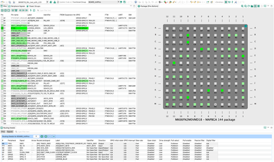

Hi,  I am using mimxrt1024-EVK as a base line reference.  I am not using the CODEC or the Motion Sensor interface.  I would like to add the following 2 analog inputs, 1 more UART, and SPI interface.  Is there a document that maps function to package pins?

As Jeremy says, the recommended way is to use MCUXpresso's "Pins" tool.  You'll want the EVK's schematic to help trace down external pin functions to µC pins, but once you have that, you'd use the Pins icon - to the right of the "<Develop>" icon in the first image - and then you'd select the desired pin and function within that tool.  The second image is for a FRDM66K, but it gives you an idea.

1)Is there a document that maps function to package pins?
-- To provide the fastest possible support, I'd highly recommend you to use the MCUXpresso Config Tools to configure the pins for the added peripheral interface.
