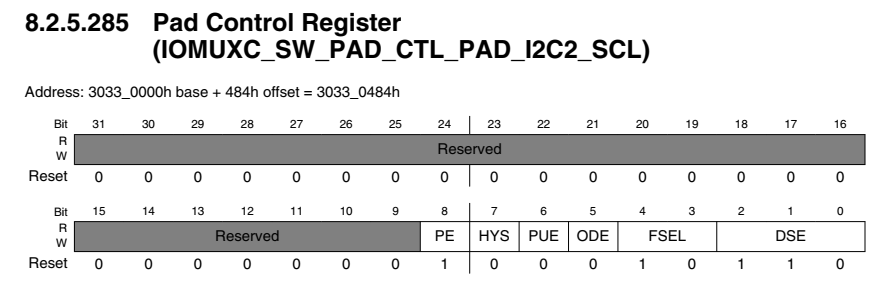

I am currently using yocto for the VAR-SOM-MX8M-MINI which uses the freescale imx8mm-var-som.dts file.  In this file, the I2C2 SDA and SCL signals are defined with an input_val of 0x400001c3.  However, referencing the  IOMUXC_SW_PAD_CTL_PAD_I2C2_SCL register defined in the  i.MX 8M Mini Applications Processor
Reference Manual
 (Rev 2.8/19), only bits 0-8 are valid.
My question is, why is bit 30 set in the DTS file?  Is there a conflict with the documentation?

Given this new information, am I still correct in thinking that the first 9-bits of this value still come from the i.MX 8M Mini Applications Processor Reference Manual as shown below?
In the future, how should I know which bits come from the reference manual, and which bits are defined by the device bindings?

Sorry I made a mistake about this, I misinterpreted your question, for pad configuration you should take a look to the devicetree documentation general and chips specific:
fsl,imx-pinctrl
fsl,imx8mm-pinctrl
As per documentation (fsl,imx-pinctrl) is the following:
Bits used for CONFIG:
NO_PAD_CTL(1 << 31): indicate this pin does not need config.
SION(1 << 30): Software Input On Field.
Force the selected mux mode input path no matter of MUX_MODE functionality.
By default the input path is determined by functionality of the selected
mux mode (regular).
As for the first 9 bits, yes you're correct you may look to the Reference Manual for pad configuration.
