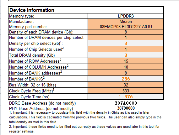

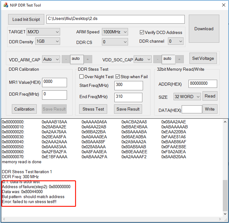

I use this tool to test MX7D.The calibration can be tested success.But when I click the stress test,it will report error.
How I can solve this problem.Is it due to a mistake in my .ds file?

  Check carefully memory parameters settings in the init (.ds) script.
Results of calibration should be inserted in the script.
