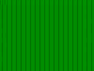

I have been testing mfw_vpuencoder on MX51/Linux board.
Firstly, mfw_vpuencoder does not produce correct result with videotestsrc, but without any error message.
gst-launch-0.10 -v videotestsrc is-live=1 ! 'video/x-raw-yuv,format=(fourcc)I420,width=176,height=144,framerate=25/1'  ! mfw_vpuencoder codec-type=std_avc width=176 height=144 framerate=25 !  filesink location=test_1.264
The generated output file (test_1.264) is quite different from the input test video.
However, if I firstly generate a test.yuv using videotestsrc, and encode the test.yuv with mfw_vpuencoder, it works well.
gst-launch-0.10 -v videotestsrc is-live=1 ! 'video/x-raw-yuv,format=(fourcc)I420,width=176,height=144,framerate=25/1'  ! filesink location=test.yuv
gst-launch -v filesrc location=./test.yuv ! mfw_vpuencoder codec_type=std_avc width=176 height=144 gopsize=10 framerate=25 ! filesink location=test.264
This time, the output file (test.264) is almost the same as the input file, test.yuv, which means that mfw_vpuencoder works well as desired.
Anything wrong with my videotestsrc + mfw_vpuencoder encoding pipeline?

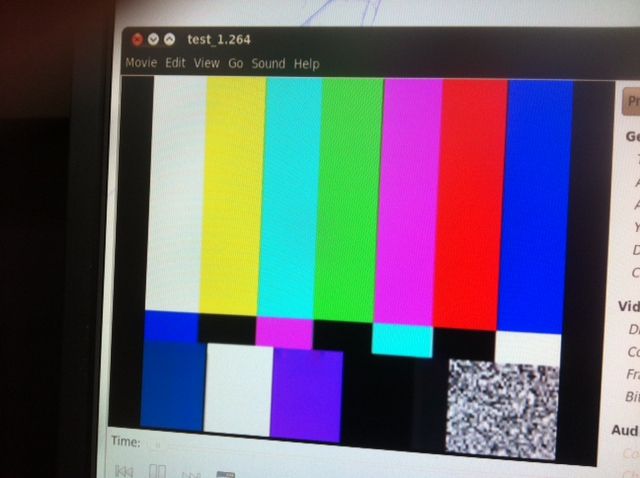

RobbieJiang
Hi Francisco,
Thank you.
I finally passed the test by setting the "peer_alloc" property of videotestsrc to false.

FranciscoCarril
Contributor V
What is the effect you are seeing?
With your first pipeline I had to remove the framerate from the mfw_vpuenc , since it caused error, but after that, it generated this video.

RobbieJiang
Here is my result:
And what's your kernel version, imx-lib version and gst-fsl-plugins version?

RobbieJiang
Hi Leo,
Finally I managed to do this with the following pipeline:
gst-launch-0.10 -v videotestsrc is-live=1 peer_alloc=false   ! \
     'video/x-raw-yuv,format=(fourcc)I420,width=176,height=144,framerate=25/1'  ! \
     mfw_vpuencoder codec-type=2 width=176 height=144 framerate=25 !  \
Note that "peer_alloc" must be sest to "false".  I don't know why, but it did work for me.
And this is very different from what I have done on MX27 (on MX27, no need to change peer_alloc. the default value is OK.), and also quite different from your pipeline.
