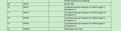

   Yes, to the RT1010 GPIO1 interrupt, the IRQ is shared:
About how to check which detail pin in the 16 pin when GPIO1 interrupt happens.

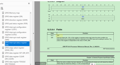

You can check this register:
Check the ISR which flag is set, then you will know which detail pin interrupt happens.

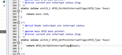

Use this code to get the ISR, then check which pin is set in the interrupt handler:
