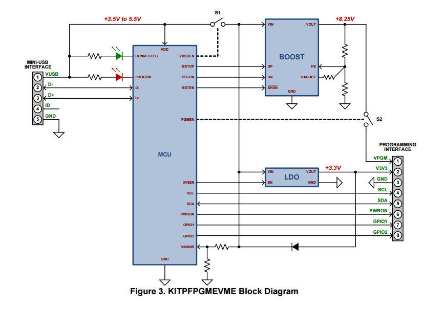

I'm having success with connecting via USB to the eval board but still struggling with getting the GUI to see the PF Programmer. According to the programmer user guide block diagram (below), the programmer is supposed to provide the target with 3.3V for the VDDIO control supply but I am not seeing this 3.3V come up. I set the jumper on J39 between pins 1 and 2 in order to power the MCU from the PVIN because I want to connect with I2C.
I guess my question is, does the programmer supply the 3.3V for the I2C or does the MCU enable the 3.3V LDO when connecting with I2C? Do I need to toggle a reset or PWRON for the 3.3V LDO to be enabled? I get the feeling I need a new programmer...

michaelbazarov
So J36 is used to program other targets through the Eval Board but I can also use the PF Programmer to program custom target boards? Both require the GUI, however, so my next questions are why doesn't the GUI recognize the PF Programmer? Or does the PF Programmer need to be attached to a valid target to be discoverable by the GUI? What does the PF Programmer need to see on the 8-pin header side to start putting out its 3.3V?

reyes
[A] Correct.
[A] GUI should recognize the PF-Programmer but it will not work until a circuit like the KITPF0100SKTEVBE or similar with a MMPF0x00 is connected to the programmer (just to be sure, I’m assuming that you are connecting the programmer without connecting the Evaluation board).
If the programmer is not been recognized, it could be related to a different problem.
We found some issues on the first revision of this board, so just to be sure, can you confirm that you are using the REV B of the KITPFPGMEVME (it should have a “REV B” white label on the back of the plastic case as in the picture below)?
Can you please let me know the “LOT” and “DTE” codes that appears on the back of your KITPFPGMEVME box, please?
[A] A circuit like the KITPF0100SKTEVBE or similar with a MMPF0x00 should be connected to the programmer in order to start working properly with the GUI.
