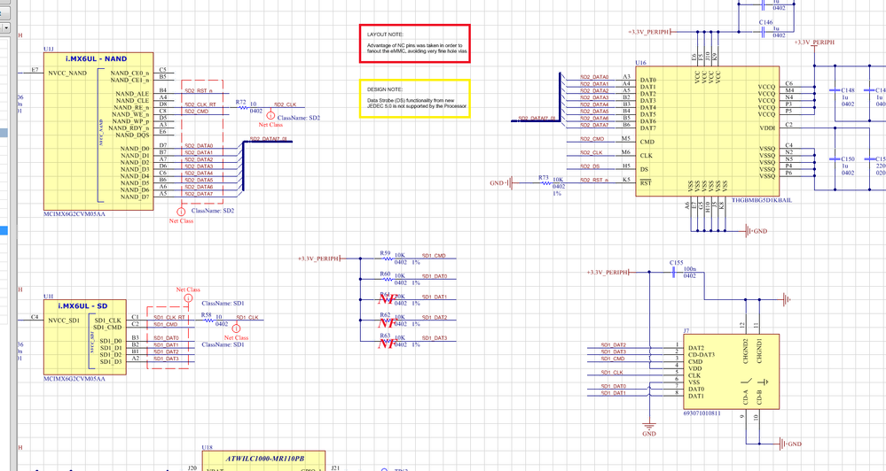

Dear all
Our board is succesfully booting from SD1
But UBOOT says MMC: no card present
Sometimes it detects the card  mmc0 is current device
But the major of the times its not being detected
We have no physical (mechanical card detect)
How can we fix the issue ?

nachodiz
We are workind from sd card (sd1)
boards are fused to boot from sd card sd1 bus
emmc is at sd2
the evk has card detect on sd1
mechanical
i think this is our problem
we have no mechanical card detect
it boots from sd1
but uboot is not seeing sd1
