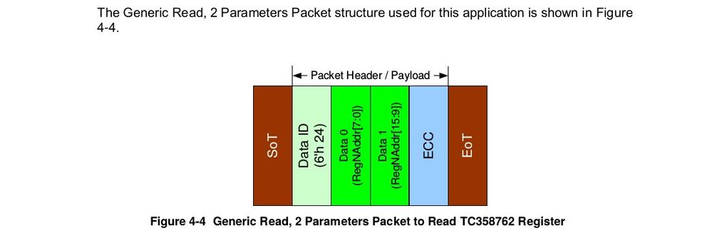

I hereby attached the DSI register read procedure from tc358762 data sheet.
We think that the DSI host not performing BTA (Bus Turn Around) properly to give TC358762 the right to transfer back the required data as mentioned in the datasheet? What do you think? Is there any other reason for this failure?

4. As per TC358762 data sheet, the Packet structure to Read TC358762 Register should be as follows,
  But dsi_pkt_read function in mipi_dsi_samsung.c doesn't seems to write the complete packet. The code from the   kernel driver writes only the packet id and MSB of register address as follows.
    static void mipi_dsi_rd_tx_header(struct mipi_dsi_info *mipi_dsi,
                  u8 data_type, u8 data0)
                unsigned int reg = (data_type << 0) | (data0 << 8);
                writel(reg, mipi_dsi->mmio_base + MIPI_DSI_PKTHDR);
    I tried modifying the code to write complete register address as below, but still the read fails.
                  u8 data_type, u8 data0, u8 data1)
               unsigned int reg = (data_type << 0) | (data1 << 8) | (data0 << 16);
Does the mipi_dsi (mipi_dsi_samsung.c) interface support two byte register address read?
