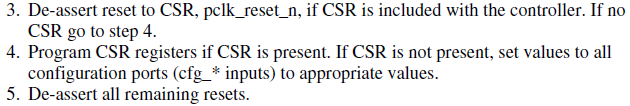

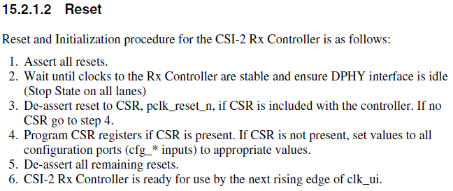

From IMX8DQXPRM.pdf (Rev.0)
I am trying MIPI-CSI2's driver porting to other OS. Please let me confirm detail of above procedure.

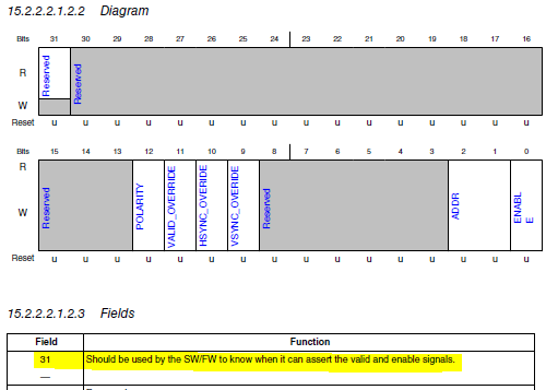

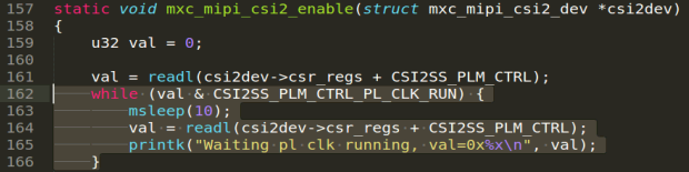

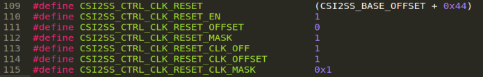

Q1. "2. Wait until clocks to the Rx Controller are stable and ensure DPHY interface is idle".
       above comments are implemented by following code. Is it right? I could not clearly understand meaning of the bit#31. because it is defined as reserved in RM.
Copy from linux/drivers/media/platform/imx8/mxc-mipi-csi2.h
Copy from linux/drivers/media/platform/imx8/mxc-mipi-csi2.c

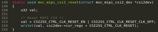

Q2. "1. Assert all resets." It is implemented by following code. Is it right?
Q3. "5. De-assert all remaining resets." It is implemented by follwoing code. Is it right?
Q4. Control is different between "Assert reset" and "De-assert reset", but the current settings are same.
       Looks like both code set to 1b to CONTROLLER_CLOCK_RESET_CONTROL register. Is it okay?

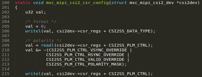

Q5. From description no.3 and no.4 in RM, we should de-assert reset to CSR before program CSR registers.
       I could not find suitable code which de-assert reset to CSR in Linux BSP.
       How do I de-assert reset to CSR?

Q1)yes, since this bit is reserved, it means that the customer don't need to care about this bit, just leave this bit as default
Q2)yes
Q3) it seems this code is for de-assert reset to CSR before program CSR registers
Q4)yes, in the bsp set them as the same value
Q5)see the Q3), in fact you can refer to the sequence from the bsp like:
if (enable) {  pm_runtime_get_sync(dev);  if (!csi2dev->running) {   mxc_csi2_get_sensor_fmt(csi2dev);   mxc_mipi_csi2_hc_config(csi2dev);   mxc_mipi_csi2_reset(csi2dev);   mxc_mipi_csi2_csr_config(csi2dev);   mxc_mipi_csi2_enable(csi2dev);   mxc_mipi_csi2_reg_dump(csi2dev);  }

Dear Joan,
I appreciate your support. Please let me confirm a few points again.
Q1 ) You told me that we don't need to care about this bit.
        But, Linux BSP is checking this bit to know the timing of pl condition.
        Should we care this bit same as linux BSP?
Q3&Q5 ) You told me that my pointed code is for de-assert reset to CSR before program CSR registers.
But, the above code is writing in mxc_mipi_csi2_enable function.
it means that the above code is for de-assert reset to CSR after program CSR registers.
Therefore, I guessed the above code is for de-assert all remaining resets from RM description.
In any case, Could you please teach me the correct register settings for the following two cases.
case 1. De-assert reset to CSR.
case 2. De-assert reset to all remaining resets.
Should we set 1b to CSI2_SS_CTRL_CLK_RESET register in both cases?
Kazuma Sasaki.
3,274 Views
joanxie
Q1)YES, I mean you can set as linux bsp, enable this bit, because this bit is reserved, so I don't find any document mentions this, just refer to the linux bsp
Q3&Q5 ) to be honest, I'm not sure if the reset sequence in the linux bsp is the same as Reference Manual, but I confirmed that customer can refer to the linux bsp sequence, the steps are csi2_reset->CSR configuration-> CSI2 enable, for de-assert reset, according to the linux bsp, should set to CSI2SS_CTRL_CLK_RESET to 1
