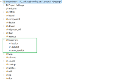

Please help me to check these files in this demo:
Their purpose is to manage the IDE-generated *.ld files so that fsl_flexspi.o and mflash_drv.o are put into OCRAM in the final generated *.ld file. You can emulate this approach to manage your project.
After that, you can use the IDE's image info feature to see the distribution of memory and code.
Gavin

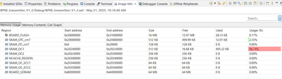

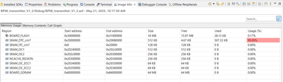

Hi @Gavin_Jia ,
I’ve already copied the linkerscript file to my project and will share the memory usage captures before and after the modification.
Before :
After :
Just to mention: my project contains a large uninitialized global array that is filled later within functions.
