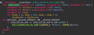

The project is built on "hello_world" multicore example. I have one simple one (basically the example) where I followed this guide and everything seems like it's working. However when it comes to this project (which is old one converted into SDK 2.15.00 and built on "hello_world" project too) I can't go past copying data sections from FLASH to SRAM. It's the process that is happening in the `ResetISR()` right after `SystemInit()`.
After some spent time on it, I have honestly no idea why it doesn't wanna work as the "simple" project.. And I'm pretty convinced I already checked every difference between these two projects. But somehow it's still not working and I can't figure out why since I already removed some custom libraries etc. so both of the projects are now "hello_world" projects where CM4 is moved into SDRAM.
The exact behaviour looks like this:
- Each of these memory segments are getting initialized just fine except the "SDRAM"
- When it comes to the SDRAM inside the `data_init()` function:
the `*pullSrc` is written only on the first address (aka 0x80000000) then it moves to address 0x80000004 and crashes.
It looks to me like there's some write access violation or something like that but still I can't figure out what is the missing piece. Or where else to look.

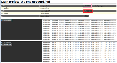

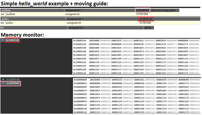

After some debugging today I'm experiencing some weird behaviour and probably found the problem but don't know how is it caused. Basically I checked the memory (break right before writing to the 0x80000000 memory space (SDRAM)) and when it comes to the simple hello_world example it looks like that:
Everything seems fine to me, there're some data etc. so I guess that's fine. However when it comes to the main project, then it looks like this:
So it looks like the SDRAM isn't initialized. But there's still like 5-10% chance I get the `????????` value one the 0x30009560 address and further on when using Memory monitor (it might be just some IDE thing - or what scares me more the memory is never initialized and the saved values are somehow from previous debug session of the hello_world example - it goes to such a hard fault that I have to:
  • change onboard SW1 to - 0001
  • boot hello_world example
  • change ondboard SW1 to - 0010
  • begin another main project debugging ).
What's also weird is the `len` value (or even the adress value - it's the same thing) which shows that even when I commented the libraries and I'm not using anything more than hello_world example at the moment, the Main project is larger for almost 10kB. And since the `pulSrc` value is different before the SDRAM write, it means either (or these are the scenerious I can imagine):

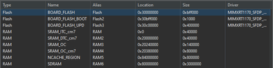

  • The CM7 part is the larger part of project even when it's coppied hello_world example - doesn't make any sense - I thought there might be something wrong with the memory setup and the sizes of memory space but it's the same for each project
  • The program starts at further FLASH address (which would be really strange bcs there should be nothing before - except the vectors etc.) - but I guess even in case the compiler for some reason move the program to further address it still shouldn't be a problem
About the SDRAM - I saw some articles about initializing SDRAM through the j-link script. I never tried one but also it can't get out of my head that the hello_world example isn't using one either and the SDRAM in hello_world project seems pretty initialized to me and according to the the CM4 debug picture shown below the CM4 part is in the SDRAM
