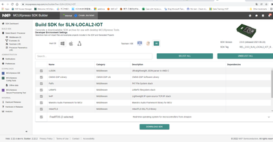

Hi @nikint
  Please check the RT106S SDK, you can find it didn't support the MDK:
That's why you can't find the keil project.
 So, to the easy get start, I highly suggest you use the MCUXPresso IDE, which is free and easy to use.
Then, even you use the related driver, you can use the SDK code directly.
https://mcuxpresso.nxp.com/en/builder?hw=SLN-LOCAL2-IOT
 But, if you just want to use the RT1060, no local detect function in the SDK, then you can use the RT1062 chip as the partnumber.
Wish it helps you!
Kerry

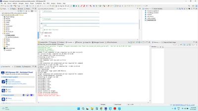

Dear Sir,
We have made a PCB using MIMXRT106SDVL6B.
Please find attached Schematic of the same.
We are using MCUXpresso IDE v11.6.0 [Build 8187] [2022-07-13] and MCU LINK PRO to load program in the same.
But we are unable to detect the device.
We have tried selecting device 1062xxxxB and 106SxxxxA , But we get Cannot connect to target.
Please find attached screenshot of the same.
Please Let us know, If we have made any mistake !
Subodh
