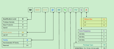

Question,
What is the difference between MIMXRT1064DVL6 version A and version B?
Thank you,
Patrice
1,701 Views
kerryzhou
Hi @lacouturepatric ,
  RT106A can't replace the RT1064, as it don't have internal flash.
  About the version A and version B difference:
It is the different silicon version, I suggest you use B version, as it is based on A version, and fix some bugs.
More details, check it's related errata.
https://www.nxp.com/docs/en/errata/IMXRT1064CE_A.pdf
https://www.nxp.com/docs/en/errata/IMXRT1064CE_B.pdf
Wish it helps you!
