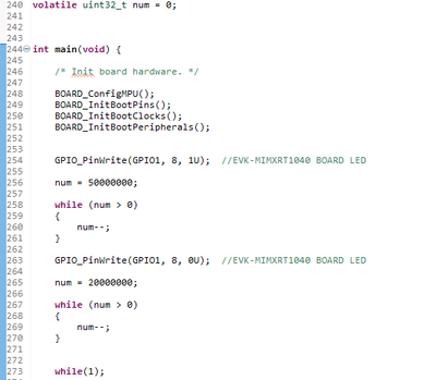

I'm creating my L2BOOT but now, to make it easy, I turned it in a very simple led toggle code.

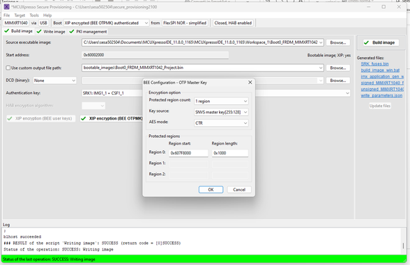

As I already mentioned, I want the Encrypted area to be encrypted with the OTPMK, but I want also the authentication of the boot image, so this is how I set up the Provisioning Tool:
After this, I loaded the application on my EVK and, after the reset, the application start as expected (just a simple toggle of the the green led).

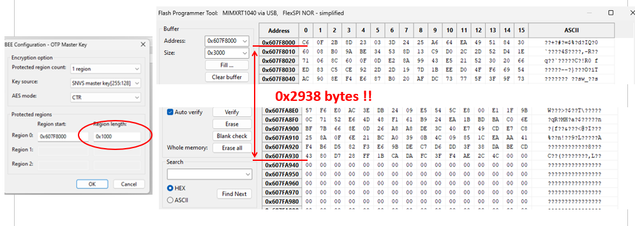

  1. I read the entire memory content using the Flash Programmer utility in the Provisioning Tool. What I saw is an encrypted region, at addres 0x607F8000, larger than the lenght I set in the building image settings. Why this difference?

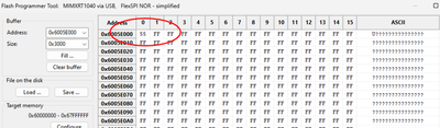

    2. After the previous procedere my boot applications starts properly. But, when I try to write some datas in my empty area (the space between the end of my application and the beggining of the encrypted area) the application doens't start.
    For example, if I write just a simple value at address 0x6005E000 and then I restart the device, my boot application doesn't start the execution (it's easy to see since it is a simple toggle led example)
    I suppose that the problem regards the HAB and the authentication process of the image. But this space should be outside my application code, so it shouldn't be interested about the HAB process...

Kan_Li
Hi @riccardo_carlot ,
Looking into your bin file, seems it occupies the encrypted area till 0x60800000, so HAB calculated all the areas , and even you just modified somewhere inside the empty area , the boot would fail. I think it was due to you defined encrypted area in the IDE, actually you may just let the SPT define this region for BEE, and let IDE only generate the application image that is signed by HAB, and in that case HAB will not take the empty area into consideration.
Hope that makes sense,
Kan

Kan_Li
Yes, your understanding is correct. Only when HAB is enabled the OTPMK can be used, but the steps for implementation should be :
1. Load plain text data into the encrypted area with the help of SPT's flash program tool.(make sure it is 16B aligned)
2. Build and Load the BEE OTPMK Authenticated L2BOOT image by SPT which defines the encrypted area is set to 0x607f8000 and length is 0x1000. (Because the encrypted area does not cover L2BOOT, so it will not influence the authentication. And the preload encrypted area will not erase.)
Hope that helps,
Kan

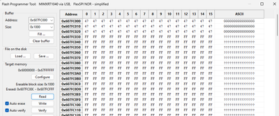

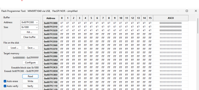

I tried your suggestion:
1- Erase all, then load the plain text on the encrypted area (some dummy 0x47 data at 0x607FC000)
2 Execute the SPT procedure to load L2BOOT setting the ecryption area at the same address 0x607fc000
After this, the content in the encrypted area (0x607fc000) didn't change. It seems the encryption didn't work on a region outside the L2BOOT memory definition:
Riccardo
