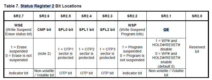

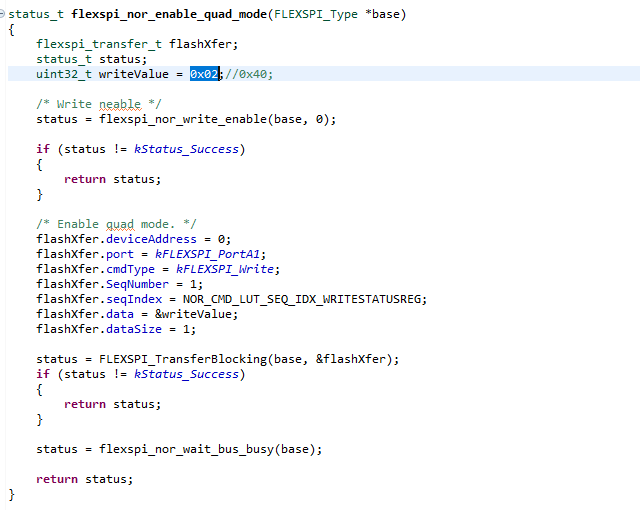

1. I don't know how you modify the flash algorithm.
   → QE bit of EON EN25QX64A flash memory is located in bit 1 of 'Status Register 2'.
        Also, Status Register 2 (WRSR2) for Write is 0x31. So I modified it as below.
2. Is that means you've program QE bit successfully?
   → If I check the QE bit after a successful download, it is enabled.
        Read Status Register 2 of EON EN25QX64A is 0x09 or 0x35. I read it as 0x09 and confirmed that bit 1 is enabled. (0x02 returned)

   → I don't understand. After trying to enable QE, the flexspi reset did not proceed. Only the QE related code has been modified. Other contents are the same as the default.
I'm attaching the Flash Driver project I'm working on. Any help would be appreciated.
