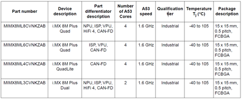

We want to know one more thing, According to our use case which is the best suitable processor for our design.
out of below two process which is the best suitable for our design.
MIMX8ML8CVNKZAB
MIMX8ML6CVNKZAB
Your feedback is important for us.
4,317件の閲覧回数
jimmychan
This table is in the datasheet. Do you need the NPU? if need, then select the part number that include the NPU.
