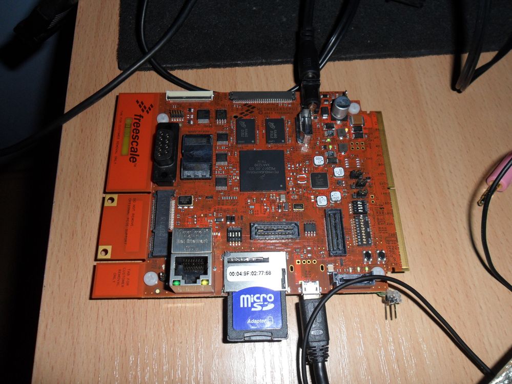

Hello
I tried to update my i.MX6 DualLite CPU Card with MTGTool2 (Mfgtools-Rel-3.0.0_121207_MX6DL_UPDATER).
I have changed boot mode pins to serial download.
I have connected my board to PC using USB OTG interface, device was properly recognized by my WinXP. Also MFGTool shows proper information: "HID compliant device". When I start the process, loading modules is working ok but it stucks on "Jumping to OS image".
Also, terminal (which works ok when booting from SD card) is not working - no information available.
It looks like all BootStrap states are performed and none of the Updater states (ucl2.xml configuration file).
Does anyone had same problem? Does anyone knows what am I doing wrong?
Also I have questions about ucl2.xml file:
  <CFG>
  <STATE name="BootStrap" dev="MX6D" vid="15A2" pid="0061"/>
  <STATE name="Updater"   dev="MSC" vid="066F" pid="37FF"/>
  </CFG>
What is dev, vid and pid parameters? Should I change somehow those? Why those are different for BootStrap nad Updater states?
In attachment is log file from MFGtool.
BR, Rafal

The host is OK. The device seems to have the problem. You had better provide the log into console for this problem.
For bootstrap mode, it refers to the communcation between the host and ROM codes through serial download protocol. The purpose of this mode is to download MFGTool firmwares (Uboot/kernel/rootfs) to the devices and then jump to the Ubootof MFGTool firmwares. The VID and PID are aligned with ROM codes.
Updater mode, it refers to the communcation between the host and MFGTool firmware through UTP defined in kernel. So its VID and PID are different.

rafalwegner
Thank you for fast response.
If I understood correctly I should not change anything in CFG part of ucl2.xml file?
If bootstrap mode is working ok (visible progress on MFGTool) and updater mode is not working at all, is it possible I am using wrong image files/configuration? I already tried: i.MX6DL-SABRESD-SD and i.MX6DL-ubuntu-SABRESD-SD (my board is i.MX6 DualLite CPU board) and use image files that comes with MFGTool.
As I stated before, my console is inactive when boot mode configured for serial download. Should some debugs be visible right from the start of MFGTool operation? Eg. While "Loading U-boot"?

lily_zhang
Host logs show it jumps to the U-boot. But no further log information. For this case, device log is useful.
If you download MFGTool from the formal web site, this tool should work well for MX6 board. You can double check you didn’t change u-boot-mx6dl-sabresd.bin and uImage under Profiles\MX6DL Linux Update\OS Firmware?
Meanwhile, Do you have the detailed information about your board – Version etc? Did you use the MFGTool with old version? How about the results?
If your device log can work, you can check whether there is uboot log into console. If not, you can check whether DDR script in MFGTool is stable for your board. If U-boot is OK, then you can check kernel part.

rafalwegner
Hello
I have changed the u-boot.bin version and now I have console working ok. But still no operation after "Jumping to OS image".
I am not able to perform any of "Updater" calls. Below  you can find log from console. You can see Linux is started and some "UTP:" debugs but no access to console and it stucks on "cpu_id is 0". Should user be able to write to console? Run a program? Could someone identify if I have problem with kernel or ramfs?

Yes, I am using sabreauto board but without base-board. Only CPU board like on picture:
Does it matter that I am using only part of sabreauto set?
I also want to use MFGTool to load firmware to custom board (with Freescale iMX6 DualLite). I am going to prepare u-boot and kernel for my board and create custom script for MFGTool. Is it possible this way? Please correct me if I am wrong and tool wan't work this way.
I am already using the newest version of MFGTool I have found on Freescale webpage: Mfgtools-Rel-3.0.0_121207_MX6DL_UPDATER
