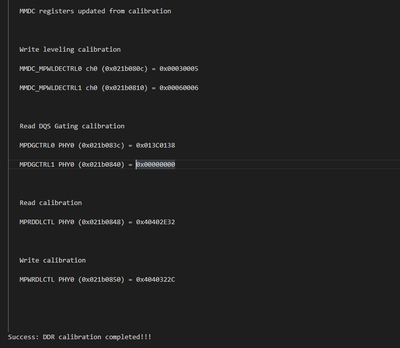

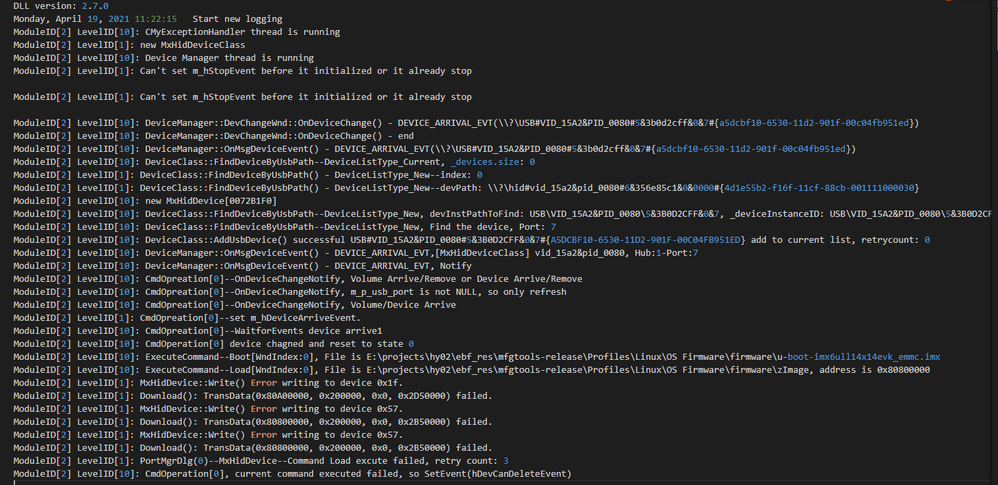

mfgtool 下载失败, chip imx6ull,  自己的板子,更换过emcp。mfgtool log 如下图
mfgtool logmfgtool log

is it custom board or EVK?  If custom, had board passed ddr test:
https://community.nxp.com/t5/i-MX-Processors-Knowledge-Base/i-MX-6-7-DDR-Stress-Test-Tool/ta-p/11082...

gjfme
hi igor:
    是custom board, ddr test 做过了, 这是calibration 结果。stress 也做了, 都没有报错。

igorpadykov
if it is custom board  then it is necessary to to update
Mfg Tool firmware files (files in ../firmware folder, fsl-image-mfgtool-initramfs-imx_mfgtools.cpio.gz.u-boot)
with updated uboot cfg file. Example can be found in
https://community.nxp.com/t5/i-MX-Processors/i-MX6DP-MfgTool-Stuck-at-Loading-uboot/m-p/1254217#M171...

gjfme
hi igor:
    我更新了imximage.cfg 然后重新编译并更新了mfgtool firmware 里的initramfs, 依然下载失败。
每次都是load uboot, load kernel, load initramfs, 然后又开始load uboot,最后卡住不动。 下面是mfgtool 的log1619258766(1).png1619258766(1).png

gjfme
试过很多次下载, 有时候错误会不一样
情况一
ModuleID[2] LevelID[1]: MxHidDevice::Write() Error writing to device 0x79.
ModuleID[2] LevelID[1]: Failed to initialize memory!
情况二
ModuleID[2] LevelID[10]: PortMgrDlg(0)--Command Load excute successfully, retry count: 0
ModuleID[2] LevelID[10]: ExecuteCommand--Jump[WndIndex:0]
ModuleID[2] LevelID[10]: *********MxHidDevice[00B0B1F0] Jump to Ramkernel successfully!**********
ModuleID[2] LevelID[10]: CmdOperation[0], current state command has been finished and the last command is successful, so SetEvent(hDevCanDeleteEvent)
ModuleID[2] LevelID[10]: CmdOperation[0] device chagned and reset to state 0
ModuleID[2] LevelID[10]: ExecuteCommand--Boot[WndIndex:0], File is E:\projects\hy02\ebf_res\mfgtools-release\Profiles\Linux\OS Firmware\firmware\u-boot-imx6ull14x14evk_emmc.imx
