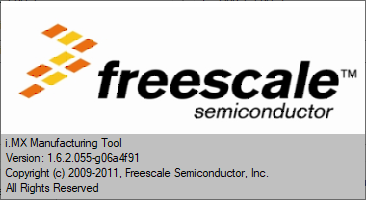

whats the command to read from the imx28
i am using the following MFG tool version
i could able to dump the file from host PC to imx28 hardware, but not read from the hardware to PC
tried this to read file ,
<CMD state="Updater" type="pull" body="abc.sh" file="files/def.sh" timeout="60">copying shell script</CMD>
file got created def.sh in host , but some two bytes able read,
any one suggestion ?
2. this version MFG crash on windows 10 but not on win7

The default BSP and released mfgtool for i.MX28 is support win7. So about on the win10 you can have a try the version MFG-Tool-V1.6.2.055.

Hi Rita,
i am using the same MFG-Tool still its failing
