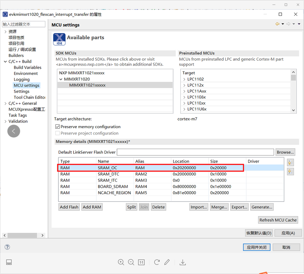

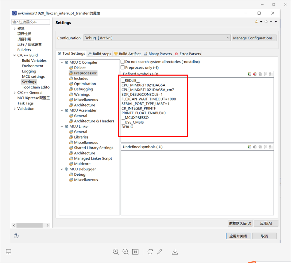

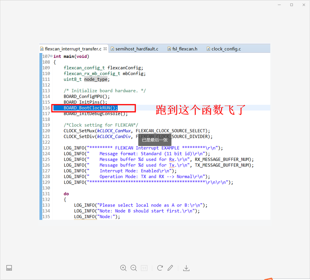

      使用sdk2.7.0的flexcan工程,将程序运行内存改为SRAM_OC,去掉XIP相关定义,程序直接跑飞,用SRAM_DTC或SRAM_ITC则都没有问题,请问是什么原因?工程修改如下(sdk代码都没有修改):

Hi zahom:
What you removed is XIP_EXTERNAL_FLASH & XIP_BOOT_HEADER_ENABLE.
If I removed these macros, none of them can work. Could you please double check?
