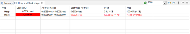

I am using MCUXpresso IDE V11.3.1 and testing one of the example code (Washing Machine demo from NXP) with Azure RTOS on MIMXRT1064 processor.
When I break in a thread and look at heap and stack it shows the stack as overflowMAUZ_0-1623279941523.pngMAUZ_0-1623279941523.png
In fact it does for any Azure RTOS code inside a thread.
Is is normal or is it a bug?
5,566件の閲覧回数
kerryzhou
Hi @MAUZ
  I get the internal reply:
The debug feature in MCUXpresso IDE does not support Azure RTOS currently. In Azure RTOS, every thread has its own stack. For example, in the following picture, the stack of thread_0 is from 0x20000718 to 0x20000b17. The current stack pointer is 0x20000af8 in the SP register. So there is no stack overflow here.
So, to the Azure RTOS project, we don't need to check the IDE stack, as that is not precise, we need to check each thread stack to check whether it is overflow or not.

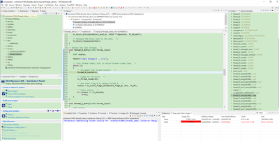

MAUZ
Thanks for the support.  I downloaded the samples from https://mcuxpresso.nxp.com/en/builder?hw=EVK-MIMXRT1064 as you mentioned. and tried the threadx demo.
I still see the stack overflow when I hit a breakpoint inside a thread. I have shared the screen shot in my original email.
Again the question is why I see the stack overload or this this a bug in the tool

kerryzhou
Hi @MAUZ
  Thanks for your confirmation, I have tested the internal new sdk version, also meet your issues, the result is:
Please keep patient, I will report it internally to the SDK team to check this issues.
