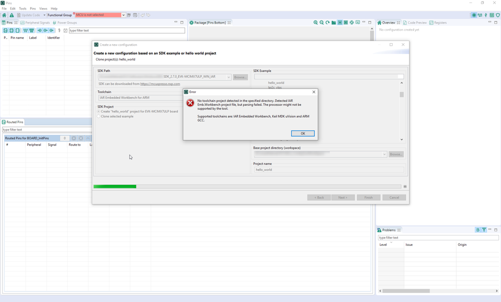

In the SDK downloaded for iMX7ULP (SDK_2.7.0_EVK-MCIMX7ULP), there are files called "pin_mux,c" for all the examples and in the comment section of that file, it is written as:
 * This file was generated by the MCUXpresso Config Tools. Any manual edits made to this file
 * will be overwritten if the respective MCUXpresso Config Tools is used to update this file.
May I know the MCUXpresso Config tool  availability for iMX7ULP processor?

yes, MCUXpresso Config Tools supports imx7ulp, you can find the supported board list:
MCUXpresso Config Tools v7 Now Available
and I installed the v7 version, then Cloning an i.mx7ulp SDK successfully

Hello Joan Xie,
Thanks for your quick response. I have MCUXpresso Config Tools v7.0 installed and while i tried to clone the iMX7ULP SDK, i get following error:
FYI:
For downloading SDK, I choose iMX7ULP with IAR embedded toolchain support for Windows (Also tried GCC ARM tool chain for Widows which gives the same issue)
Jai Ganesh Sridharan

jaiganesh_sridh
No. I am still not able to import the SDK into Config Tools. Facing the same issue mentioned above.
Here is what I have done:
1. Download SDK from Welcome | MCUXpresso SDK Builder (SDK 2.7.0; Choose iMX7ULP eval board with tool chain as IAR embedded work bench and OS as Windows)
2. Download the MCUXpresso Config Tools v7.0
3. Open Config Tools and import downloaded SDK (extracted package).
Facing same issue mentioned above.

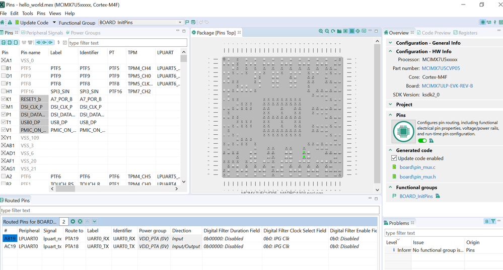

joanxie
this is my SDK, I can port it successfully, maybe you can try it
