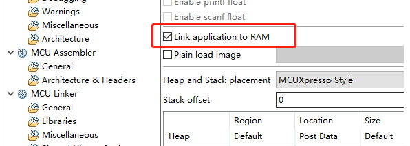

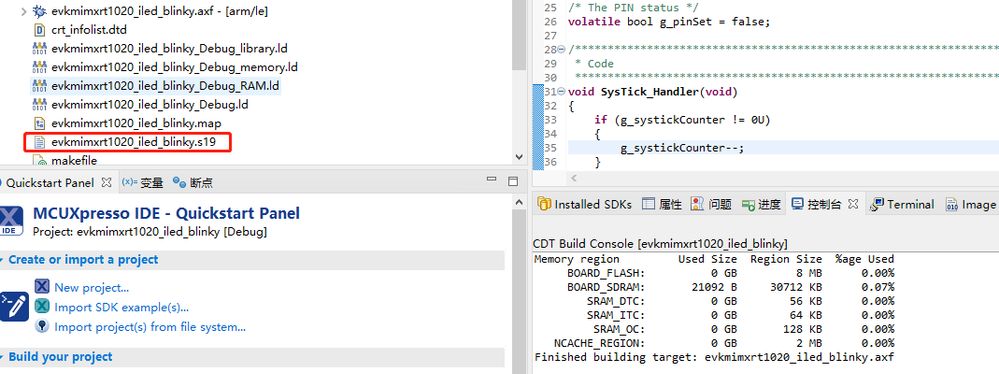

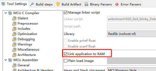

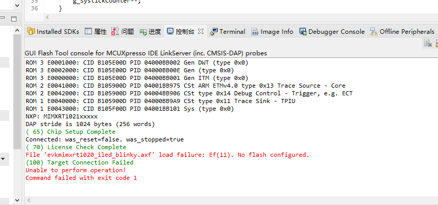

I used MCUXPresso IDE to import a project evkmimxrt1020_iled_blinky, checked Link application to RAM, and compiled successfully. However, the following errors occurred when downloading to the EVK board, please help to analyze the problem,thanks.

Hi @jarman_zhou ,
Since the application is link to SRAM, it needn't flash. But it seems you want to program it to flash. You method won't work.
To download SRA</SDRAM application to flash, lease refer to this post.

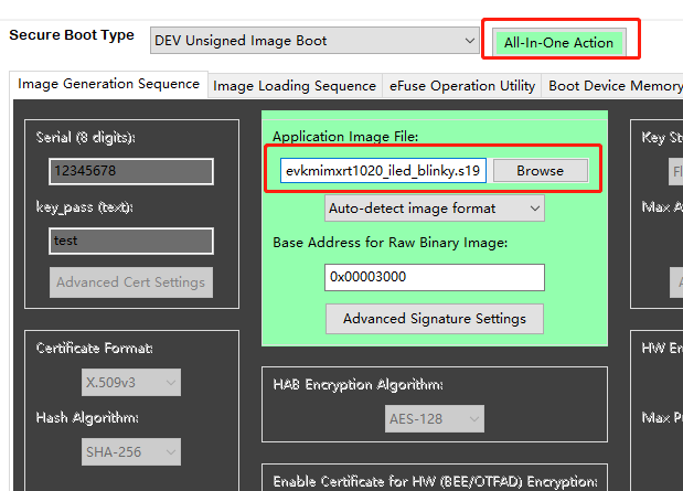

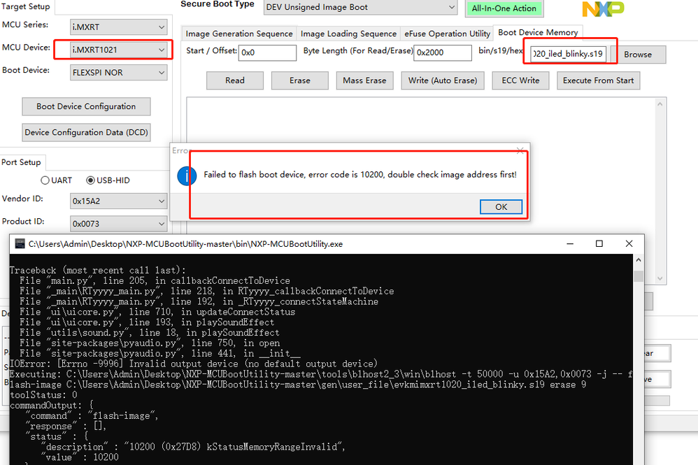

I completed steps 1-6 according to the article,Then use MCUBootUtility to download.s19 files to NOR flash,The following error message is displayed:

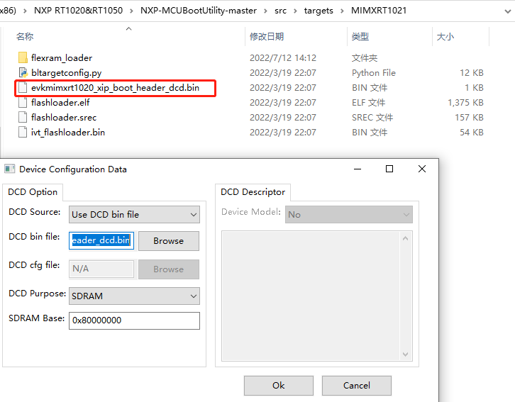

2.Add DCD by MCUBootUtility
In step 3, set the Device Configuration Data,I choose to C:\Users\Admin\Desktop\NXP-MCUBootUtility-master\src\targets\MIMXRT1021\evkmimxrt1020_xip_boot_header_dcd.bin,The following error is displayed when you click OK:

Where do you want the application run, SDRAM or DTC or OCRAM? All of them need to put the application at base_address+0x2000. Please try the second method again. I don't know why there is "permission denied" in your log. Is there security issue?

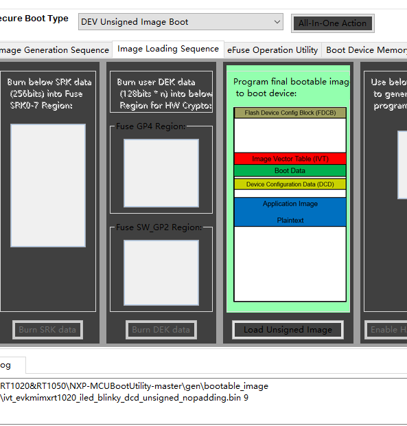

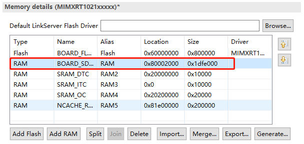

I put MCUBootUtility into another directory to successfully burn the application. I ran the application in SDRAM, but the program did not run after the burning, and there was no print out of the serial port. Here are my specific operation steps.
1.Memory configuration, specify RAM as SDRAM and modify the offset address.
2.Select Link application to RAM.
3.Compile the project and generate the.s19 file.
4.Configuration of DCD and burn the image.
The above is my detailed operation steps.

The problem has been solved, the reason is the IDE inside also want to add DCD macro, thanks.
