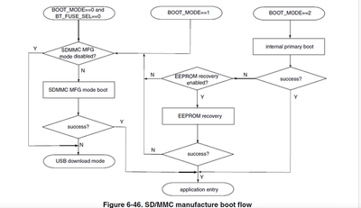

This is confusing, since the reference manual (IMX7ULPRMB2, Rev. 0, 09/2020) chapter 35.2.9 says that uSDHC0 and uSDHC1 is canned and if a valid boot image is found, that image will be loaded:
In manufacture mode, SD or MMC card will be scanned on uSDHC0 and uSDHC1. If
card is detected and valid boot image is found in card, then the boot image will be loaded and then executed. Pad of SD1_CD is used to detect whether card is inserted.
I didn't see that the MCU started booting from the SD card even though there was a valid boot image on the card, that worked fine for "Internal boot" but not for " Boot from fuses". In chapter 35.2.2.1.1 i found the following:
Setting BT_FUSE_SEL=0 in Boot From Fuse Mode forces the ROM code to jump
directly to the Serial Downloader. This allows a bootloader to be downloaded which can then provision the boot device with a Program Image and blow the BT_FUSE_SEL and the other boot configuration eFUSEs.
This seems a little contradictory to the first quote, since manufacturing mode is enabled as default, when no fuses are configured, but here it says that with BT_FUSE_SEL=0, the MCU will always jump to "Serial Downloader mode".
However I burned the  "BT_FUSE_SEL" and the MCU booted correctly, but leads to another questions - would have achieved the same by "Disable SDMMC Manufacture mode"? And in which cases would you prefer to set "Disable SDMMC Manufacture mode" instead of BT_FUSE_SEL?

1. No, those functions have different applications.
2. Disable SDMMC Manufacture mode needs to be used when one boot option is not available and needs to use an alternative.
