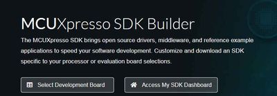

   Is MCUEXPRESSO Ide supports for the IMX8M MINI EVK board, if it supports can you share the SDK for Linux OS  and the procedure for building, using the boards.
1,877 Views
igorpadykov
Hi Vinith
yes i.MX8M Mini EVK is supported, it can be built on below link
https://mcuxpresso.nxp.com/en/welcome

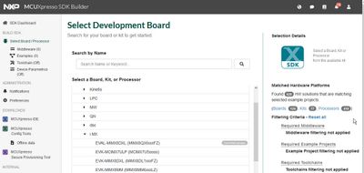

After selecting the exact processor there are two files and which I need to choose
1,858 Views

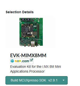

igorpadykov
1.select Development Board:
2. select EVK-MIMX8MM(MIMX8MM6XXXLZ)
3. Build

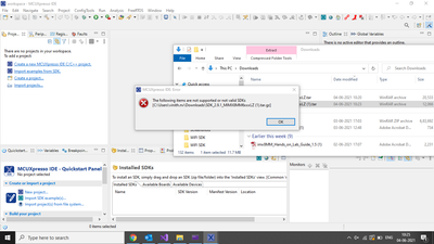

VinithNama
 I was able to download the sdk when i was dragging the zip file into the installed sdk it throwing the above error
