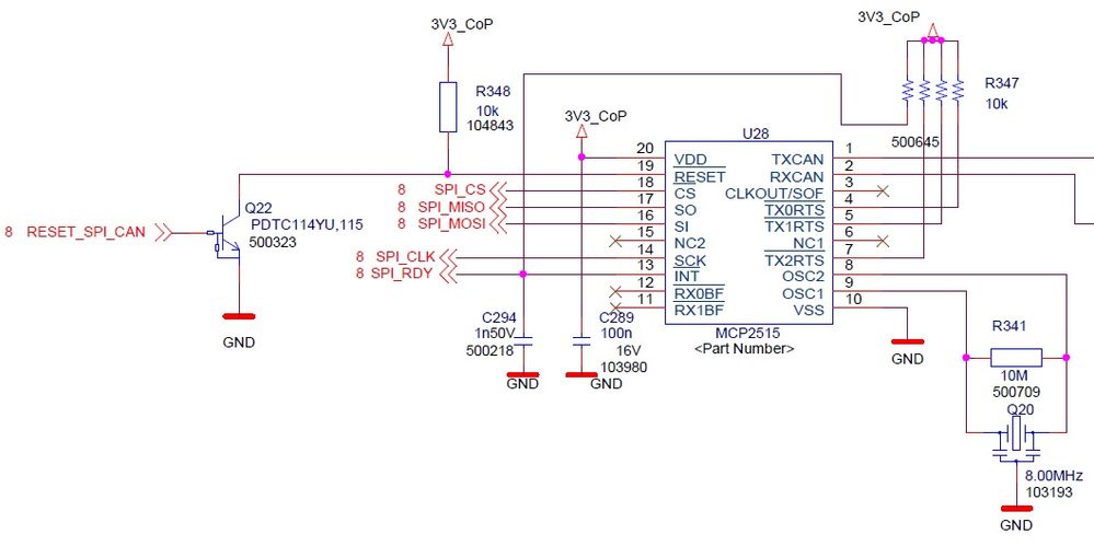

We have designed a custom board using the i.MX6UL that will have three CAN buses.  I'm using flexcan for the first two CAN buses, and using the Microchip MCP2515 via SPI on the thrird CAN bus.  I'm using kernel 4.1.15.  I have added the MCP251X driver to the kernel, but the driver is never loaded.  The only output from dmesg says the following:
# dmesg | grep spi
[ 0.437217] spi_imx 2010000.ecspi: probed
If I add a spidev node, it will load but not the driver for the MCP2515.  Could u-boot be doing something to the pins that would mess up spi in the kernel?  My device tree is found below...  any ideas why this is not working?

igorpadykov‌, I reviewed this post, but I don't see how this is related or where the debugging procedures are located.  I added debug statements to the mcp251x.c driver and found that the error is the mcp251x_hw_reset function, where it reads the register.  The register that it reads is coming back as 0.  Any thoughts on why this would be happening?

jsmith883
igorpadykov‌,
The oscilloscope reads that I'm sending 0x0E, which according to the mcp251x.c driver, is correct (it's the very first thing that the driver transmits).  I updated the driver to match the latest version in the mainline kernel, and here is what I get from dmesg:
[ 0.444582] spi_imx 2010000.ecspi: probed
[ 0.457894] mcp251x spi2.0: Cannot initialize MCP2515. Wrong wiring?
[ 0.463077] mcp251x spi2.0: Probe failed, err=19
The issue is MISO never moves.  I've tried different MCP2515 chips, but nothing seems to ever come out of the chip.  Does my device tree and schematic look correct?  Anything else it may be?

igorpadykov
since MISO never moves, it means that mcp251x does not send data, probably
it was incorrectly initialized or its schematic circuit is not correct, one can apply to Microchip tech support.
