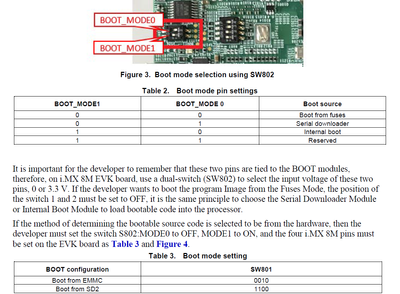

I downloaded the BSP for Android 12, built it successfully without any errors, and flashed it using the UUU command. The flashing process indicated success, but the board is not booting.
I also tested with a pre-built image, but it exhibited the same behavior.

Do you download the images to sd card or emmc? Have you set the proper boot mode for it? At the same time, which version MCIMX8M-EVK board are you using? Could you share to us?

I tried booting with both emmc and sdk card and also boot pin are made as per the documentation
Also i don't kno the exact version of the board

Coudl you share your setting for both EMMC and SD card, I can check it for you.

we have used the SW801 switch configuration for boot mode as
SD card 1100
EMMC  0010
SW802 switch as  10

What is the board version? Could you share the picture to us?
