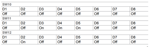

Hi!
I just bought this development board and want to use the MFG_TOOL tool to download programs to QSPI. No matter what I do, it just won't work. I just want to ask how to operate the DIP switches S1, SW10, SW11, SW12 to download.
772 Views
AldoG
For this purpose you may set dip switch to boot from SD card slot SD4, just make sure that there is no SD card plugged.
Power on the board, after the message "HID Compliant device" is displayed on your host PC, the board has entered serial download mode. After this is done you should be able to download an image using MFG_TOOL
