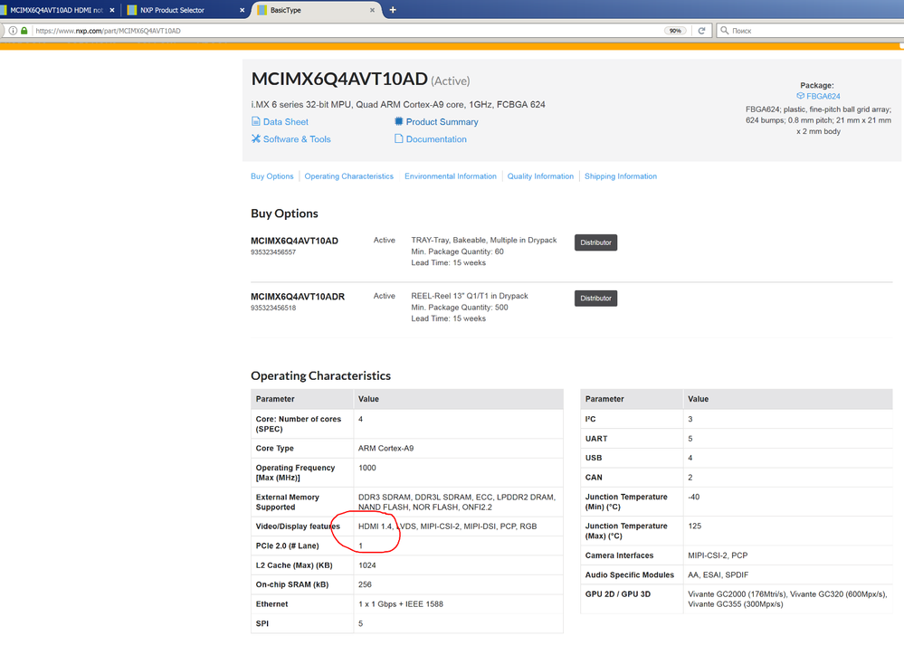

Hi all,
HDMI not working on my custom board based on MCIMX6Q4AVT10AD.
Register reading:
HDMI_DESIGN_ID:0x00120000 =  0x00
HDMI_REVISION_ID:0x00120001 =  0x00
HDMI_PRODUCT_ID0:0x00120002 = 0x00
MCIMX6Q4AVT10AD not have VPU. Does not HDMI also?!
The identical assembly of LINUX works fine on the board with the MCIMX6Q5EYM10AC processor.
Questions:
1) If the CPU does not have a VPU, then there is no HDMI?
2) If the MCIMX6Q4AVT10AD has HDMI, why is HDMI_DESIGN_ID read as 0?
3) Is there any difference in the turning on of HDMI for processors with and without VPU?
Thanks.
Mikhail Burkov

mikhailburkov
Hi Fabio!
Thank you very much for your help.
VIDEO_27M_CLK_ROOT, needed for HDMI, in default LINUX assembly routed through VPU. If VPU not present, then HDMI block not have a clock. In this case we must a enable MIPI clock:
/* Turn on MIPI core cfg clock */
reg = readl(&mxc_ccm->CCGR3);
reg |= MXC_CCM_CCGR3_MIPI_CORE_CFG_MASK;
writel(reg, &mxc_ccm->CCGR3);
HDMI on MCIMX6Q4AVT10AD works fine!

joanxie
vpu is for coding video, hdmi is for display, no vpu doesn't mean no hdmi.
if you want to know if your chip support hdmi  or not, pls "fuse read 0 4 1"
one can read 32 bits fuse map from bank 0 work 4, the bit 7 is for HDMI, if it is 1, then the chip has no HDMI.
2,426 Views
mikhailburkov
Joan Xie, thanks for your answer.
I read the register 0x021BC440 (Value of OTP Bank0 Word4 OCOTP_CFG3):
MCIMX6Q5EYM10AD: [0x021BC440] = 0x00620302. HDMI works normally on this processor.
MCIMX6Q4AVT10AD: [0x021BC440] = 0x00628302. HDMI not working!
How so?! The NXP site (BasicType ) speaks about the presence of HDMI from the MCIMX6Q4AVT10AD processor! In datasheet and reference manual there is also no data about the absence of HDMI!
2,426 Views
mikhailburkov
The contents of the registers [0x021BC440] differ only in bit 15.
Bit 7 for both processors is 0.
That is, both processors have HDMI?
Why then can not enable HDMI on the processor MCIMX6Q4AVT10AD?
