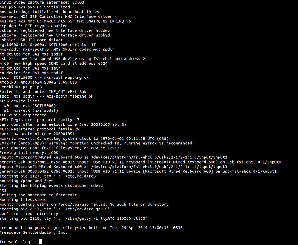

I got MCIMX28EVKJ: i.MX28 Evaluation Kit . The Linux pre loaded SD card  which comes with the kit boots finely. I don't have an LCD but i can see the messages via UART Debug port.  But the USB port of the board is not detecting USB keyboard. What will be the reason?
In the boot up messages its shows the name of the keyboard but keyboard is not powering up .

have you tried with a different USB keyboard? (different brand or a "non-multimedia" keyboard).

Now am getting something like this...i tried Logitech keyboard still no hope
Freeing init memory: 152K
USB Host suspended
usb 2-1: configuration #1 chosen from 1 choice
input: Logitech USB Keyboard as /devices/platform/fsl-ehci.0/usb2/2-1/2-1:1.0/input/input2
generic-usb 0003:046D:C31C.0001: input: USB HID v1.10 Keyboard [Logitech USB Keyboard] on usb-fsl-ehci.0-1/input0
init started: BusyBox v1.15.0 ()
starting pid 1070, tty '': '/etc/rc.d/rcS'
input: Logitech USB Keyboard as /devices/platform/fsl-ehci.0/usb2/2-1/2-1:1.1/input/input3
generic-usb 0003:046D:C31C.0002: input: USB HID v1.10 Device [Logitech USB Keyboard] on usb-fsl-ehci.0-1/input1
827 Views
ganeshh
Yes its not showing up anything...
